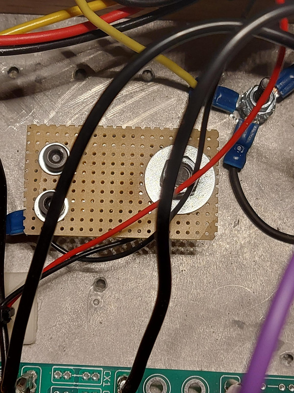

8899 Posts
Posted - 2025/05/08 :  00:03:46  Show Profile  Visit Ryssen's Homepage Send Ryssen a Private Message  Reply
Ground breaker ala veroboard.
Komponenterna sitter på undersidan.
