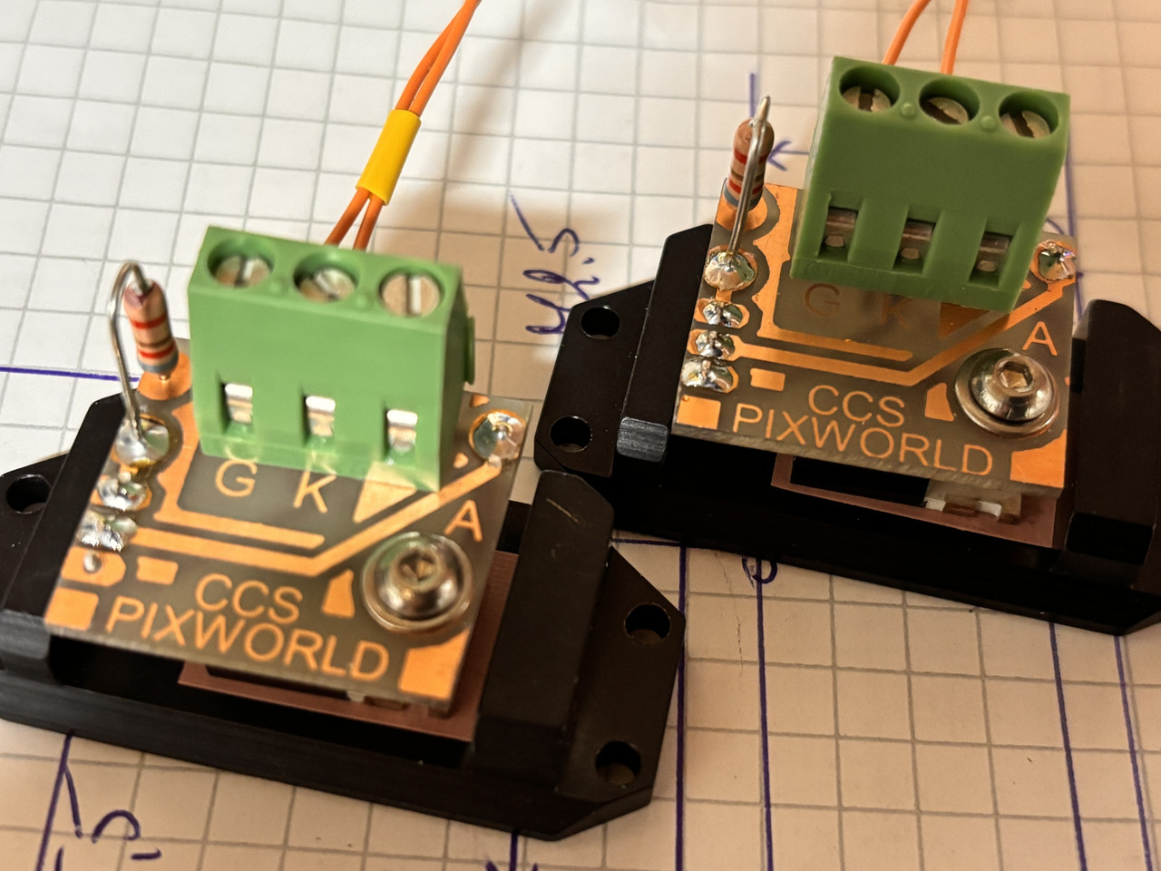

Posted - 2026/10/22 :  16:32:30  Show Profile Send pix a Private Message  Reply
Ett par CCSer tillverkade
Edited by - pix on 2026/10/22 19:30:26
