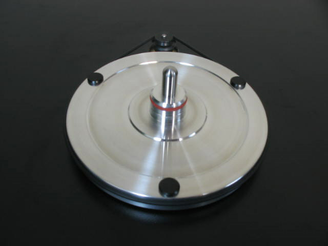

The Deluxe version utilizes 3 interchangeable contacts (Delrin or Brass) for even greater versatility and performance. A premium quality Ruby bearing is supplied.
Price: $225

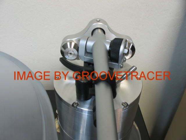

VTAF#8482;
The VTAF allows smooth and easy adjustment of VTA with the record playing, so that the user can hear the sonic changes as they occur.
The VTAF mounting system isolates the tone arm from the arm board, preventing arm board resonances from being excited, and returning down the tone arm to the stylus, where they appear as late arrivals, which blur the sound. The benefits of the VTAF mounting system are improved sound stage, imaging, inner detail, nuance, air, bass clarity, and musicality.
The VTAF Teflon Upgrade reduces friction, allowing operation of the adjuster wheel to be even smoother and easier. More important, the VTAF Teflon Upgrade increases tone arm isolation from the arm board, adding to the isolation benefits noted above.
In Laquered Brass the VTAF for your Rega RB301 is priced at $180 U.S. In Smokey Silver the price is $220 U.S. Also available are the VTAF Teflon Upgrade, at $30 U.S.
